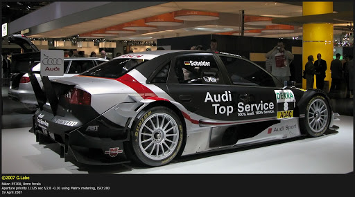

J. Edlund
The solutions for front end aero for DTM cars have today become more and more like those used for LMP cars, with the main differences being the use of a conventional hood, front placed radiators and a front engine.
Modern DTM cars use a space frame chassis with a carbon fibre survival cell so they are not limited to what the stock chassi can offer. The engine and the driver is placed quite far back in the car.
http://upload.wikimedia.org/wikipedia/comm...A4-DTM_2008.JPG
http://lh3.ggpht.com/_ZfOXWlGjnMA/Rjcb1AiT...diA4DTM.005.jpg
http://www.racecar-engineering.com/article...04/1/0/dtm.html
