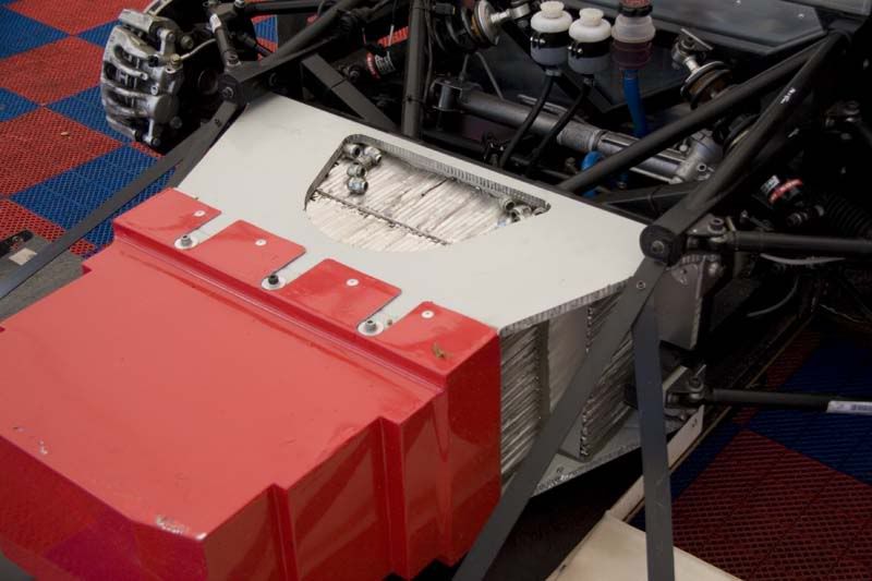

#65 zac510
zac510
  • 1,713 posts
Posted 08 December 2008 - 14:55
I've got a picture at home of one of those Peugeot 206 open top racers that supported the LMES. They have an enormous chunk of al honeycomb at the front which I can only presume is a crash structure. I'll post it up this evening.

#70 Greg Locock
Greg Locock
  • 4,907 posts
Posted 09 December 2008 - 11:39
Check out the material they use to make the deformable crash barrier for offset crash. It is an alloy honeycomb, which they then erode chemically to give the right crush characteristic.
Here's some
www.plascore.eu/eu/energy/barriers.php
Anyone thinking a box of drinking straws gets my vote.
#71 McGuire
McGuire
  • 9,218 posts
Posted 09 December 2008 - 13:44
Unless the vehicle is really enormous or really light or goes really slow, beer cans and even bubble wrap have gigantic crush cells for our purposes, relatively speaking. We need eensy teensy tiny cells, and zillions and zillions of them, to protect a small and heavy mass (car and occupants) in a short crush stroke. Like a closed-cell polystyrene foam, for example.
Thought experiment: would bubble wrap be a good choice as roll bar padding? Why not?
From there you want a material that is a) cheap and b) already validated for the purpose, for instance Dow Impaxx foam - same stuff as in the doors of the NASCAR CoT, and in OE production applications. The NASCAR door pieces (four to a car, two to a side) are about the biggest pieces I have seen: around five feet long, a foot and a half tall, and about a foot deep, and like any closed-cell absorptive foam can be trimmed to fit.
http://www.sae.org/t...rs/2008-01-2971
http://www.dynamore....ers/D-III-1.pdf
http://www.stockcars...fety_IMPAXX.php
#72 zac510
zac510
  • 1,713 posts
Posted 09 December 2008 - 20:54
Here's the Spider Cup car:
I'm not sure what's inside the red plastic section. I'm guessing it's full of foam-like stuff that McGuire is talking about?

Have any of you guys seen CYMAT aluminum foam?
http://www.cymat.com...ngProducts.html
They have very interesting characteristics when inserted into a crash box. Instead of getting an energy absorption of a + b, depending upon the relative energies of the two elements you can get up up to 7(a+b) as the aluminum foam flows into they folds of the crash box.
After Earnhardt's death I worked with a group to build an energy absorption element for NASCAR. They wimped out and went for the SAFER barrier instead.
