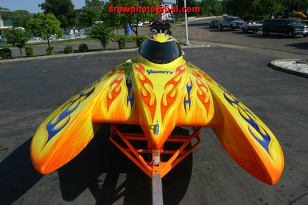

This a joke of a thread. I see all these arguments about how a canopy is useles, hinders the view, won't take a hit,etc etc etc.
We used F-16 canopies for years and had zero issues with them on these.

As was posted earlier.... F1 powerboats have been using canopies for years. Ultimately I believe F1 cars will look more and more like fighter jets with canopies in the future and if need be, the glass will be blown by "Det cord" just as a pilot does when he ejects., if a driver needs to be extracted from an upside down car.
