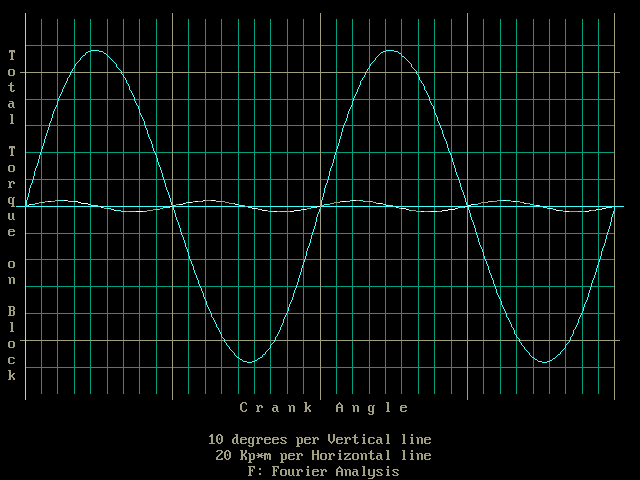

#106 manolis
manolis
  • 545 posts
Posted 20 April 2012 - 06:24
I wrote most of the following 5-years ago in another forum:
An in-line four (or I-4) four-cycle with cross-plane crankshaft means uneven firing intervals.
Instead of the standard 180 crankshaft degrees interval between successive combustions of the conventional “plane-crankshaft” four in-line, like:
I____I____I____I____I____I____I____I
in the cross-plane the firing intervals are 270 crankshaft degrees, then 180 crankshaft degrees, then 90 crankshaft degrees and then 180 crankshaft degrees, like:
I______I____I__I____I______I____I__I
and the sound from the exhaust reminds something like the “gallop pace”.
Regarding the unbalance of the cross-plane I-4 (by the way, with the balance program at http://www.pattakon....duc/balance.exe you can see graphically and by numbers all these), it is different than the unbalance of the conventional I-4.
Besides the heavy unbalanced 2nd order inertia force, the conventional I-4 has also a heavy 2nd order inertia torque:
(the inertia torque on the block and the inertia torque on the crankshaft are the same).
The short curve is for the cross-plane I-4, for equal stroke, rpm, piston mass etc.
2nd order means that it maximizes and minimizes two times per crankshaft rotation.
An idea for this “heavy inertia force”?
In a typical 1600cc I-4, at the red line the unbalanced inertia force is more than 1 ton, i.e. more than 7 times the total weight of the engine.
In the reasonable question: “and why the engine, under the action of such a strong force, doesn’t leave its place/position?” the answer is simple: “it does” and the engine vibrates, i.e. it moves up and down in the rhythm of the acting force, i.e. if you take a “fast” video of your engine running at 6000 rpm (i.e. at 100 crankshaft rotations per second) you will see the engine going up and down 200 times per second .
The elastic engine mounts isolate these vibrations from the car – or motorcycle- frame.
In the expensive cars they put a pair of counter-rotating 2nd order balance shafts (i.e. they rotate at double crankshaft speed) to create an equal and opposite force and so to cancel the 2nd order unbalance force of the conventional I-4.
With the proper offset (along the cylinder axis) of the two balance shafts, besides the inertia force, it is also counterbalanced the inertia torque on the block of the engine (however, the heavy inertia torque on the crankshaft and on the flywheel cannot be reduced).
What the “heavy inertia torque” means?
At high revs the inertia torque is stronger than the instant torque generated by the expansion of the gas into the cylinder. This actually means that if you take the actual torque that arrives to the flywheel from the crankshaft, it comprises a strong “inertia” part that offers nothing but stress and friction and a useful torque that finally moves the vehicle.
To really understand the meaning of the inertia torque, look it from the energy view point: in a conventional four in line (I-4) with plane crankshaft (i.e. with crankpins at 0, 180, 180 and 0 crankshaft degrees) when the first piston is at the TDC (top dead center) all the four pistons are immovable (their velocity is zero), i.e. their total kinetic energy is zero (kinetic energy: 0.5*m*V*V, where V is the speed of the piston and m is the mass of the piston with the piston rings and the piston pin and the upper part of the connecting rod). After 90 crankshaft degrees, all the four pistons move quickly and have concentrate a strong amount of kinetic energy. At the BDC (i.e. after another 90 crankshaft degrees) the total kinetic energy of the pistons is zero again. I.e. there is a strong “take and return” of mechanical energy between the flywheel and the pistons two times per crank rotation. And this strong inertia torque does not contribute to the vehicle motion. It just stresses the moving parts of the engine and increases the mechanical friction.
The conventional four in line is not so perfect as you used to think.
And what about the cross-plane I-4?
Here the total unbalanced inertia force is zero.
Also the total unbalanced inertia torque is actually zero (i.e. there is no reciprocation of inertia torque between the flywheel and the pistons). I.e. in the rear tire of the Yamaha R1 arrives only useful energy that makes easier the life of the rider (better feeling, drive closer to the limit etc). The clutch can operate without springs.
Just like in the V-4 with 180 degrees crankshaft.
But there is a pure 1st order strong plane inertia moment. By using a 1st order counter-rotating balance shaft (i.e. it rotates with the crankshaft speed at opposite direction) the total unbalanced inertia moment of the engine becomes zero.
That is, with one balance shaft the cross-plane straight four is better, as regards its inertia balancing, than the best V-8 ! and way, way better than the conventional I-4
The only asymmetry that remains is the uneven firing.
For someone who has a V-8 in his car, he can simulate the cross-plane I-4 by removing the ignition and the injection from the one bank of cylinders. That simple.
As for the turbo applications, one can start by seeing how the V-8 deals with this problem. If a turbo can serve successfully one bank of cylinders, like in the picture below (chevy), the same is true for the turbo-charging of the cross-plane four in line.
The drawback of the cross-plane I-4 is the uneven firing and the need for a 1st order balance shaft (which is way easier and involves way less friction than the two 2nd order balance shafts necessary for the balancing of the conventional I-4).
Another drawback is the lower peak power as compared to the flat-crankshaft straight four (with equal intervals between the exhaust pulses, the tuning / breathing is better).
Back to the conventional flat crankshaft I-4:
The clutch passes to the gearbox both, the “working” torque (i.e. that from the combustion-expansion-compression) and the inertia torque (which, at high revs, is several times stronger).
From another viewpoint, the main torque the clutch and the gearbox passes to the wheel is the inertia torque, with the “working” torque passing like “noise” onto the inertia torque! This is the case.
These two torques have the same “main frequency”.
Any attempt to damp the inertia torque, kills a part of the “working torque” too.
A solution is to allow the crankshaft to rotate at slightly variable angular speed (slightly faster at TDC and BDC wherein the pistons stop moving, and slightly slower at middle stroke wherein the four pistons move quickly) while the primary axle of the gearbox rotates at constant angular speed.
If in the primary transmission (from the crankshaft to the clutch) the gear-wheel on the crankshaft is of special design like:
then the flat crankshaft I-4 no longer passes inertia torque to the gearbox, keeping all its rest advantages.
Manolis Pattakos

#107 gruntguru
gruntguru
  • 5,806 posts
Posted 20 April 2012 - 07:07
Thanks Manolis. At last somebody has given us an estimate of the relative amplitudes of the inertia and combustion torques.
The inertia torque amplitude is of course determined by the ratio of reciprocating vs rotating masses ie a heavier flywheel or lighter pistons will both reduce the inertia torque.
Inertia "torque" is probably not the most appropriate term (as I mentioned in an earlier post) because the result of this "imbalance" is actually best expressed as a speed or KE variation. The amplitude of the resulting torque oscillation will depend on what the engine is connected to - ie the reselience of the drivetrain.
#108 manolis
manolis
  • 545 posts
Posted 20 April 2012 - 09:21
Gruntguru,
Here is an estimation of the relative amplitudes of the inertia and combustion torques:
The peak “working” torque of an even firing 4 cylinder is about 3 times its mean torque.
Without a turbo, the mean torque of a racing 1000cc is difficult to pass the 12 Kpm (at 18000 rpm it gives 300 bhp), i.e. the peak “working” torque during the expansion is 36 Kpm.
For a 1000cc 4-cylinder motoGP engine, the maximum allowed bore is 81mm, which means 48mm stroke.
The piston of Honda B16A2 VTEC (red line at 8000rpm) is also 81mm in diameter and has a mass of 300 gr.
Its wrist pin is another 100 gr.
The connecting rod is 600 gr.
I.e. the reciprocating mass per cylinder is about 300+100+(600/3)=600 gr.
Lets say the reciprocating mass of the motoGP flat-crankshaft 1000cc I-4 engine is only half, i.e. 300 gr per cylinder.
At 18000 rpm (28.8 m/sec mean piston speed) the inertia torque (balance program at http://www.pattakon....attakonEduc.htm ) is 125 Kpm of 2nd order (by the way, the unbalanced inertia force is 2,5 tons of 2nd order too).
I.e. the clutch receives a “working” torque of 36 Kpm peak, and 125 Kp of inertia torque (i.e. more than 3 times bigger).
Worse even, the "working torque" varies from a small negative value (say -10 Kpm during compression) to its peak positive value (36 Kpm), while the inertia torque varies from -125 Kpm to 125 Kmp, i.e. the "3 times bigger" is too conservative; the "5 times bigger" is more realistic).
That is, the "working torque" passes to the gearbox/wheel like "noise" over the way stronger inertia torque "carrier".
“The inertia torque amplitude is of course determined by the ratio of reciprocating vs rotating masses ie a heavier flywheel or lighter pistons will both reduce the inertia torque.”
No, the inertia torque amplitude is not related to the rotating mass.
I think what you mean is: "the variation of the angular velocity about its mean value is determined by the ratio of reciprocating vs rotating masses".
Instead of increasing the rotating mass (not good in a racing engine: the response to the throttle becomes slower, to change direction becomes more difficult, the weight increases), the true solution is the use of a special gearwheel (like in the last post) on the crankshaft which, besides engaging the crankshaft to the clutch, it also allows the two parts (the crankshaft, at one side, and the gearbox–wheel at the other side) to rotate as they like.
What actually happens now, is that the system is overloaded (friction, fatigue etc) trying to make the crankshaft to rotate at constant angular velocity, which is not necessary.
I can’t see why the bike makers are not using, yet, this solution.
As I know, the cross-plane crankshaft of R1 is neither a recent patent, nor Yamaha's.
Manolis Pattakos
Edited by manolis, 20 April 2012 - 09:22.

Here is the inertia torque of the SXV 77deg
Here is the comparison of the SXV 77 deg inertia torque to that of a V-90 degrees or a I-2 with crankpins at 0 and 90 degrees (Ducati, last Yamaha TDM):
Here is the inertia torque of an even firing I-2 (crankpins at 0 and 360 degrees, cyan curve) versus a I-2 with crankpins at 0 and 180 degrees:
Here, in the previous plot it has been added, for comparison, the inertia torque of the SXV 77 degrees:
Here, in the previous plot it has been added, for comparison, the inertia torque of the V-90:
The above are for same pistons, same connecting rods, same revs.
The inertia torque of the SXV – MXV is quite small (only a little bigger than a V90 like ducati).

According some drawings from the Internet, the crankshaft of the Aprilia SXV and MXV has a single crankpin (i.e. no crankpin offset).
The following plots (made by the balance program at http://www.pattakon....attakonEduc.htm ) are for different arrangements.
The big bang cannot justify the big difference in traction between the SXV and the MXV you ride.
If the effect of the big bang (which leaves the tire to calm down before the next power pulse) was so decisive, then the four in line would never be able to compete in a race.
The inertia torque of the 1000cc even firing 4-cylinder at 18000 rpm (moto GP) is, for same piston and same stroke, four times stronger (two times because of the two more pistons, and another two times because of the higher revs) than the inertia torque of the I-2/180 deg arrangement at 13000 rpm, which is already 2.5 times stronger than the inertia torque of the SXV-77deg at the same 13000 rpm.
I.e. the even firing I-4 motoGP passes to the rear tire, at 18000 rpm, ten times stronger inertia torque than what your SXV – MXV passes to the rear tire at 13000 rpm, while both engines (I-4 motoGP and SXV – MXV) have actually the same “working” power pulse (combustion-expansion-compression).
What I think is that the big deference between your big bang MXV (combustions at 0 and 77 degrees) and your SXV (combustions at 0 and 283 degrees) comes from the substantially different tuning.
The first has lower, but smoother, torque curve, and linear increase of torque with the throttle position, while the second sacrifices the linear response (like the old two strokes) for the sake of the peak power.
It would be interesting if the MXV engine was tuned to give the peak power of SXV. This would be the correct comparison.

What I did was to calculate / approximate the inertia torques of various engine arrangements used in racing motorcycles.
This is pure, and quite simple, mathematics: after a few basic assumptions, I finished with a number of curves that (without being absolutely correct) help in understanding a little more what happens inside the engine, in the gearbox, on the contact of the tire with the road, in the clutch etc.
I deliberately kept away from the calculation of the working (combustion) torque.
Another champion, this time from motoGP, had a different opinion than you. Evaluating his big bang Ducati (a quite similar architecture to your MXV) versus his screamer Ducati (“more screamer” than your SXV screamer), the difference for him was small, if any. He used to ride the big bang (i.e. he was familiar with the big bang), then he made a number of rounds with the screamer in order to evaluate which is the better: “I am leaning on sticking towards the big bang, but . . .”
As I understand it, the worse “traction” screamer SXV needs more power in order to follow the big bang MXV.
More power for the screamer means more “peaky torque” and less linear response to the throttle, which worsens even more its traction control.
