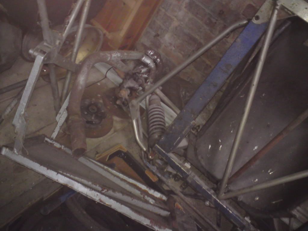

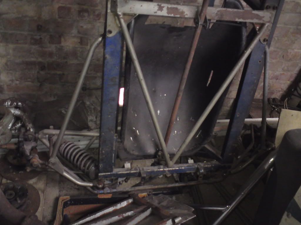

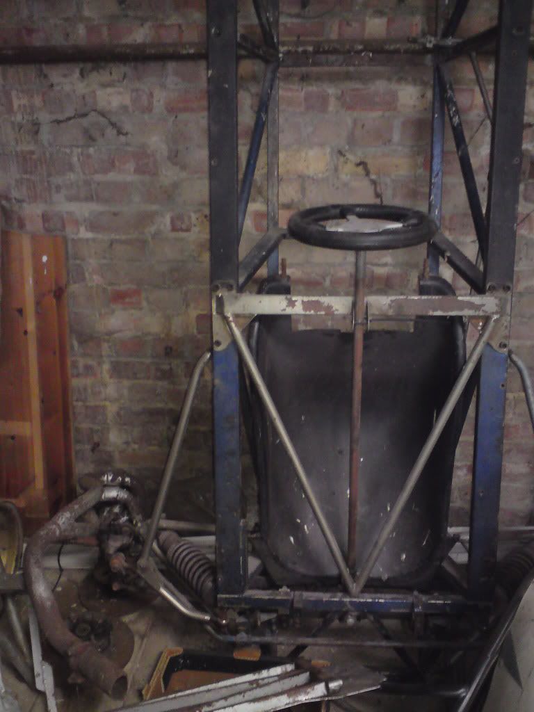

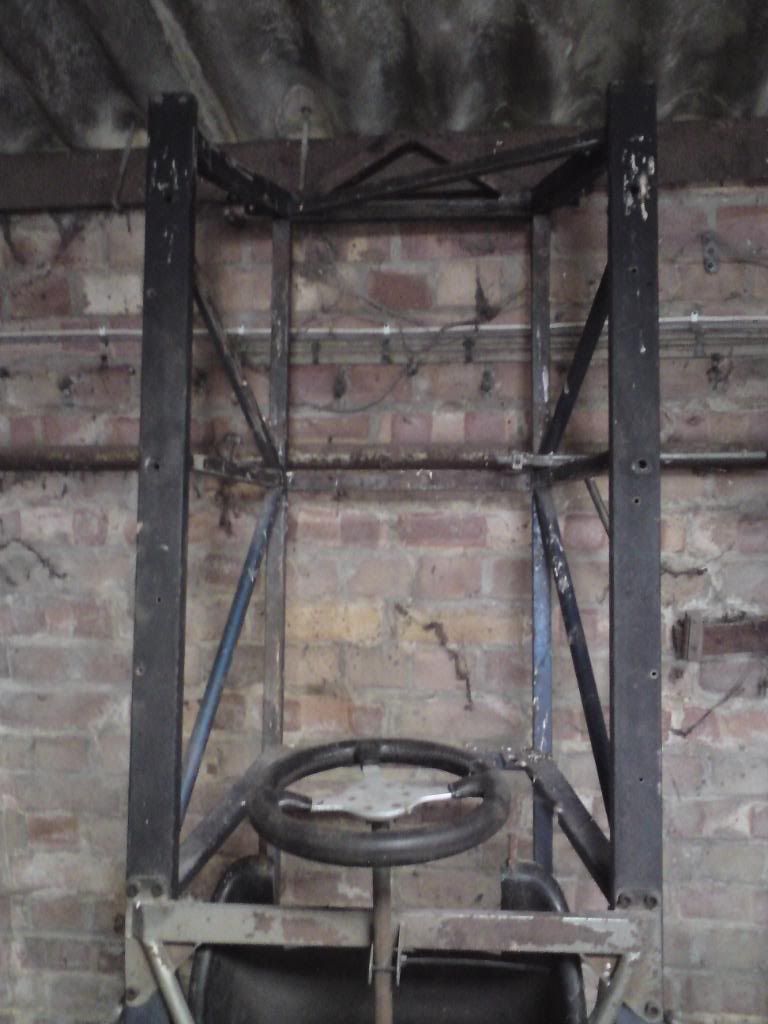

Hello all,
I have just joined the forum having read some fantastic threads and seen some amazing pics :love: , it's all very addictive!
I have just had my first 'Barn Find' experience, i'm not sure if this is the right place to post, but as there seems to be a vast expense of historic motorsport knowledge within these forums i thought there might be a good chance of someone identifying my find.
This appears to be a Formula ford, it has Triumph uprights and kent engine mounts. It is rumoured to be a Rostron, however i'm finding it difficult to obtain any informaton on this marque. The car is in many bits at the moment as can be seen and interestingly it has a boltable rear lower chassis section and chassis to gearbox mount triangulation as well as a bolt on roll hoop! Unfortunately there is no bodywork, but it is otherwise complete.
Hopefully someone out there can identify it from the mess of parts!?
Thanks for looking, Ollie

I fear that Henk has got his Rostron history slightly wrong, or the book he got it from is wrong.
Carl Rostron built his own Formula Fords during the nineteen seventies from a workshop in Wrotham, Kent. The cars were very conventional for the period, it could be said conservative, and bore a similarity more to a Wimhurst Palliser than a Brabham. Carl built his own chassis and wishbones etc. although some components were sourced outside. One of the cars was kept at Carl's and run as a sort of quasi works effort, for a chap from the Channel Isles, whose name escapes me.
Mike Thompson purchased what I think may have been the second car and he and I ran it from my ASD workshop in Leeds, Kent. I modified the car quite heavily, changing both the front and rear suspension geometry and adding some extra stiffeners to the frame. I also built the engine in the Leeds workshop. This car, as you say, Mike drove to the MCD championship, winning if I recall seven races during the year. Carl Rostron incorperarated some of my modifications into the 'works' car.
After the championship year Mike bought a Reynard FF 2000 car and sold the Rostron. Later in the year Mike took over production of the Rostrons from Carl although by this time the car had new bodywork with a rounded nose and side radiators. The chassis were built by Mike's father in Newhaven and the cars were then put together in the ASD works, where Mike rented some space. Later Mike built a garage at his home and put the cars together there. These cars were not a great success, by now being out of date.
Mike Thompson later changed the name to Quest with a new car of his own design, set up his own facility and went on to more illustrious things. Although ASD produced both Rostron and Quest components they never built chassis for either make. Quest eventually went out of business as a manufacturer.
Now the mystery car. I am do not think it is a Rostron as they had round tube chassis and the suspension does not bear any resemblance to the CT cars, it looks way too light as well. The Rostrons did use Triumph front uprights with Lotus 51 rear units. The rectangular top tubes shown in the photographs were quite common around the mid seventies period and I am sure I have seen this type of chassis before as the 'bent' wishbones look very familiar, along with the bolt on top dash tube. In fact I seem to recall once repairing a similar chassis after a shunt. However I would need some more longer range pictures to be sure.
The photographs of the Rostron in the paddock look like the 'works' car to me. They appear to have my suspension changes and the car was black back then although I well understand that colour changes are common and easy.
Best of luck if I can offer any more help get in touch.

Thanks all for your replies,
Henk, that car looks very pretty, i wish it was that one i found!
The chassis is getting more mysterious as it seems to not be a Rostron and looks like neither a Brabham or Palliser.
RJE, I will try and get some better pics asap.. shame the bodywork got thrown away. I thought it was early 70's because there is no hoop over the steering wheel and i seem to remember hearing of a regulation change on roll hoop height regarding the forward angle over the drivers head from around this time. It seems unique that from the cockpit back inc the main roll hoop everything is boltable. Can you remember how long ago you repaired that car with similar bent front wishbones? It seems this one has been stood for a long time.. would be fantastic if it was the same one, and it had a name!
Also, i forgot to mention the chassis was found with a METSO gearbox, which i read something about being a custom dogbox vw based similar to the Hewland. I don't know whether this will help with identifying the chassis as i'm not sure it originally ran with the car. The plot thickens :confused:

I doctored a few of them so more detail is visible:
This makes a few things clearer... details like how the tubes come across the top in front of the cockpit and bolt in place over those rectangular longitudinal members. I've never seen anything like that before, maybe the builder was afraid of being trapped in a crash and wanted it to be easier to be freed from a bent car?
The rectangular tubes, by the way, were used at that time to give extra anti-intrusion protection in the event of a side impact. But what chassis ever had the cockpit bulkhead removable?

Sorry but I cannot see much Dulon. A close examination of the two sets of photographs will show very few similarities between them, other than the fact that they are made of tube, all be it different shapes and sections, and both have springs and dampers.

I dunno. To me the attachment of the steering column to the dash bulkhead says "AMATEUR". I cannot believe a professional would ever bolt that bulkhead to the longitudinals much less hold a steering column under what appears to be a bent nail in a bracket. Maybe it's some kind of homebuilt dirt or dune buggy?

I'm not sure this car ever ran. I can see no gear linkage attachment points, and how was the gearbox held in place. The steering column was obviously meant to have a bush at the top end but no sign of wear or marks where it would have been.
Although by modern standards the chassis looks a bit basic there were many early FFs that had similar frames to this although usually built with a bit more thought, as is shown by the obviously hasty rethink of the pick up for the bottom rear wishbone. It would also appear that the front top pick up points are bolt on almost as if it was expected that geometry changes may be needed. Perhaps somebodies first try or a prototype for a future project???
Where was it found, that may shine some light on it?

Sorry it's taken so long to reply, i have been waiting to get some better pics of the chassis; by the time i finally got round to it, i managed to pick the darkest day of the year! So apologies for the poor quality.
Many thanks to all of you that have replied, i am currently in agreement with most that it is a home build possibly monoposto or hillclimb. Although i have now found out that there is a ff1600 dry sump kit, Hewland bellhousing adapter, formula ford spec brakes and wobbly wheels all looking very uncleaned since the 70's!
The rear uprights also look custom made with triumph style hubs as used by ff.
I found a complete gear linkage assembly that has a bearing link which interestingly mounts on the boltable roll hoop where there is a tubular mount welded underneath. The chassis was loosly assembled for pics and i was surprised at how easily and well everything lined up, considering how many parts are removable. Of note, the front and rear chassis sections join together at the top utilising the same bolts that hold the roll hoop assembly and rear top radius rods in place... some important bolts! :eek:
The gearbox has Hewland Style sideplates with lugs which line up with holes in a rear top crossmember that the rear suspension hangs off. The gearbox appears to also be supported from the underneath by a square rear floor section, again boltable as is the rear chassis side triangulation where the engine mounts..side only! :eek:
The car was found in the mid Hampshire area, not sure how long it has been there though.

The engine bay frames look to have been made by a different person to the rest of the chassis.
Apart from being round rather than square section the welding looks to be very professional.
If they bolt to the driver bulkhead I would think they are from a monocoque car - they look similar to the frames used on early Marches etc.
The rest is so unusual that anyone who had seen it would remember it!
Could be worth posting the pictures on the 750MC website (if that is possible - maybe under the wanted section) someone there might know more?
