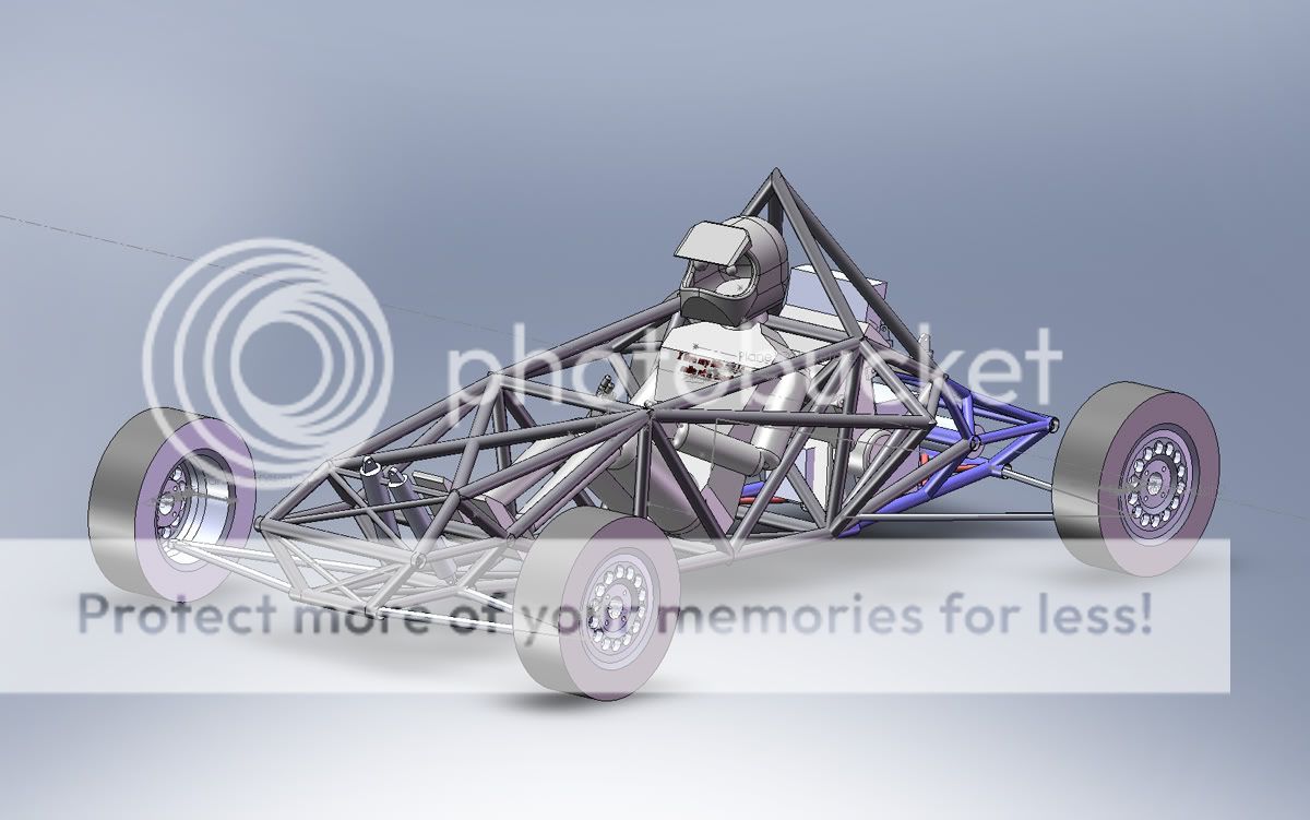

gordon murray's LCC Rocket has a real nice structure around the cockpit... I'll try to find a pic...
on my project I used a much simpler method of regaining the stiffness lost by the opening... but it works..
#15 Tony Matthews
  • 17,519 posts
Posted 25 October 2009 - 23:24
You mean the driver acts as a structural member? Cool!
