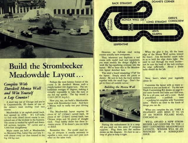

Strombecker slot car plans from circa 1962.
