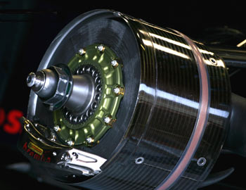

Hey guys, this is my first post on the forums here. I wanted to discuss inboard brakes in F1. Most people here seem to think it would be advantageous to decrease the reliance on aerodynamic grip and increase mechanical grip. In my opinion it would seem logical to mount the brakes inboard and use liquid cooling with a separate radiator (I know liquid cooling is banned). A small vent in the nose like the 2008 Mclaren could also be used to further assist cooling.
Mechanically it would be more complex, but steel brakes could also be utilised to reduce cost. Fitting the front brakes in the nose may also pose some difficulty.
As I see it the benefits outweigh any negatives. It would significantly reduce unsprung weight and therefore increase mechanical grip. Aerodynamically it could be more efficient.
Are inboard brakes banned in the rules or do the teams just prefer outboard brakes?
What do you guys think?

Taxman:
It has been done in F1 before but i think its banned. prob to do with the fact that if the drive shaft/transfer shaft breaks your going to have a mega crash.
but today i think it should be possible to make such a shaft basically bullet prof. Or have both one tinny brake at the wheel and a beefy at the gearbox, as a failsafe.
pic of cars with inboard brakes: http://www.facebook....mp;id=836285018

I can't find any reason behind the advantages you claim, I can however see several problems and reasons why such a system would have a negative impact on the car.
The brakes operate at high temperatures (about 500-1000 degC) and handle very high power rates (peaks around 2000 kW). To cool the hot brake discs directly with air will require a much lower airflow (equals less aerodynamic drag) than to cool a say 130 degC coolant. Heat radiation from the discs are also an issue, so I would prefer to have the brakes in the wheels rather than within the body of the car where the heat can affect several components.
For F1 cars, the airflow from the front wing (between the wheels and the tub) and the flow to the lower rear wing are important and with inboard brakes this airflow will be more restricted compared with brakes in the wheels since the space inside the wheels are 'free'. Especially if we consider the driveshafts required with inboard. The front would also require some sort of bearing for the disc.
The current carbon/carbon brakes are very light, just a few kg per brake, this is no significant issue in terms of unsprung weight. Add the weight of driveshafts, radiators and such and the current system is lighter.
It's also questionable if iron (not steel) brakes would offer any significant cost reduction.

Edlund: thats a silly rule, carbon today is prob cheaper than magnesium wheels. the heat protection of the carbon inside the wheels is prob not cheap either if i know F1 traditions correct.
Forged magnesium rims are light (a F1 rim is around 3 kg), durable and quite cheap to produce. Carbon fibre rims are light, but also less durable and more expensive.
The carbon fibre shields within the wheels are not heat protected by any special means.
#30 MatsNorway
MatsNorway
  • 2,831 posts
Posted 22 January 2010 - 17:34
thanks man. How come the carbon don't burn up? Covered in more carbon? (graphite?)

  • 1,323 posts
Posted 23 January 2010 - 12:08
Cooling air flow around the uprights and through the brakedisc keeping it and all the shrouding cool. It is possible that the inside surface of the shroud has some form of heat reflecting properties, a thin layer of metal foil or a paint with metal pigment is probably enough to reduce heating due to radiation. The small air gap between the disc and the shroud means that it can only be heated by convection and radiation, not conduction. Given the airflow, heat radiation is probably the only heat transfer method that has a significant impact.
Temperature resistant matrix can be required for the carbon fibre instead for the conventional epoxy.
Carbon fibre is also used as heat shields for exhaust manifolds.
