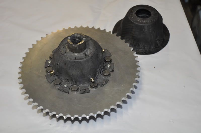

First diff cover below - vacuum bagging was not well done, but it worked. Grease nipples feed directly onto helical gears. Unfortunately the finish is not as I would like, but I am rushed atm and will do a 'cleaner' one when it is proven to work!
#18 24gerrard
24gerrard
  • 2,008 posts
Posted 29 July 2011 - 10:02
Great job Niel, brings back memories of the old days.
Although the casing parts we made were mostly steel or alloy.
With a light car the loading on the components should be fairly low so it should last well.
So long as its greased often.
I hope it seals well enough.
It might be of interest, in the electric performance cars, two electric motors are used with belt drive to each drive shaft.
Diff action is undertaken with the control unit electricaly.
#19 NeilR
NeilR
  • 623 posts
Posted 29 July 2011 - 11:29
Thank you. It was a rushed job fitting in around other things, but I think it will work. Seals will be silastic ones. The top of the housing has .5mm spacing from the steel of the diff and the bottom will have a bead of 5-8mm. The seals have no structural load and the cover is a form fit over the diff itself. It actually has to be tapped onto the diff to fit.
