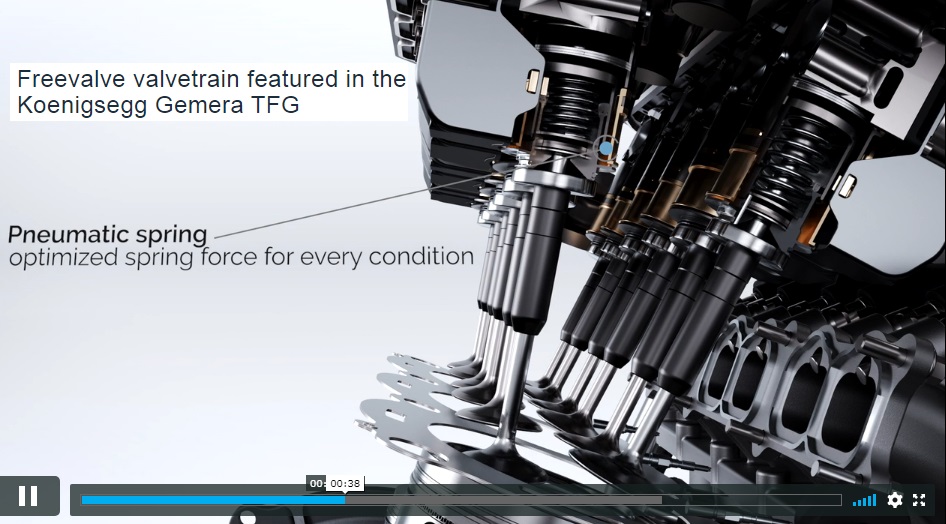

In the following slide (from the above video):
they are shown restoring valve springs (big ones).
At the opening of the exhaust valve, the pneumatic system has to take the force from the pressure inside the cylinder (minus the instant pressure in the exhaust port, which is not, at all conditions of operation, high), it has also to take the inertia of the valve (rev limit 8,500rpm), it has also to take the force of the restoring valve spring.
I.e. the pneumatic system has to operate at high pressure.

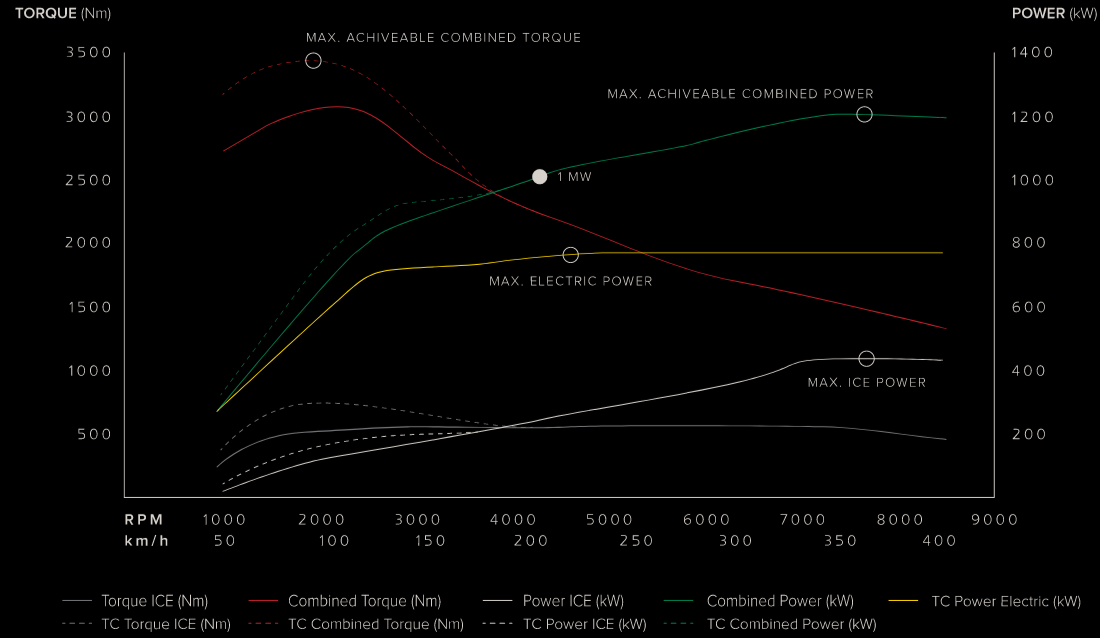

From the following plot:
it seems that the extreme power (600PS) of the ICE (Internal Combustion Engine) engine of Gemera is not really significant for its performance (acceleration, final speed).
At peak power, only the 1/3, or so, of the power comes from the ICE, the rest is from the battery.
If instead of 440kW, the engine provides only 90kW peak power, the performance would drop only slightly (760+90 = 850kW instead of 800+400 = 1200kW).
Actually the sum of the peak powers of the three electric motors is not 760kW but ~1000kW, with the one electric motor being on the crankshaft.
What dominates in Koenigsegg’s Gemera is its electric system, not its internal combustion engine; the internal combustion engine is there to charge the battery.
Despite its lightweight engine (only 70Kg), Gemera’s dry weight is 1715 kg.
With 70Kgf weight the Gemera engine makes 440kW (600bhp), which means a specific power of 8.5bhp/Kg (6.3kW/Kg, 3.9bhp/lb).
And this engine is green and fuel efficient.

 1. Is the main duty to charge the battery? There is also a direct mechanical coupling between engine and wheels and as you say, it is a 600bhp engine so is more than capable of propelling the car and charging simultaneously.
 2. The engine can be optimised at all revs and loads.
 3. See 1 above.
 4. It only has 50km of electric-only range (I assume they do not allow the battery below a certain state of charge to keep full performance available) so the ICE operates for most of its 1000km range. Mazda offer very smooth quiet vehicles with 2.5 litre 4 cylinder. No doubt Koenigsegg have the vibrations sorted.

On the question of air pressure. The "Restoring springs" do not exert much force at valve closed. The pneumatic piston has a larger diameter than the valve seat. 20 bar air pressure would provide a significant force - approximately 2kN.
