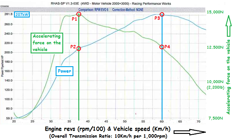

There are two main forces with act on an accelerating car (for the sake of simplicity, let's assume it's on level ground and we'll don't take into account losses and rolling resistance, which are usually small in comparison): the advance force on the traction wheels and the aero drag.
Let's divide the moving car into two different ideal half-cars:
1) a car with the original car's mass and moving in vaccum.
2) a car devoid of mass but having a body moving in a draggy atmosphere
For the first car, the maximum acceleration is obtained with the maximum forward push (2nd law of Newton). This forward push is proportional to the torque applied to the wheels, itself proportional to the engine's torque (constant of proportionality depending on the kinematic chain) and therefore, the maximum acceleration is obtained at peak torque. Peak power is irrelevant.
For the second car, there is no mass to move and therefore torque applied to the wheels is irrelevant. In that case, the more power you can get (which is, by definition, the produce of drag force by speed), the more you can overcome the drag and the quicker you can go.
Real world cars are a mix of both ideal cars. At low speeds, aero drag is of little importance, so cars will look ideal car 1 and will have the the maximum acceleration at or near the torque power. At high speeds, considering that drag is proportional to the square of speed, it will be the dominant factor (like in ideal car 2) and power will become essential for accelerating.
Which is consistent with the well-known fact that torquey cars accelerate well from traffic lights, but only powerful cars keep pushing above 200 kph.
That "constant" of proportionality is only constant if you're stuck in gear.  Every pro-torque argument ultimately rests on this fallacy of keeping a non-constant constant.
It's a widely shared belief, but it's not a fact.  If you compare 0-60 times for different cars, you will find that power to weight ratio is a much better predictor than torque to weight ratio.

Posted 24 October 2017 - 06:04
Hello Kelpiecross.
You write:
"The highest acceleration in a particular gear would be at the power peak surely?"
Here is modified the plot in the post #287 of V8 Fireworks:
Force_vs_Speed_vs_Power_vs_Torque_Mitsub
The green curve "Accelerating force on the vehicle" has identical shape with the original torque curve.
At 60Km/h vehicle speed (i.e. at 16.7m/sec), wherein the engine revs at 6,000rpm, the engine makes its peak power (282HP / 207kW).
The relation between the power provided, the speed of the vehicle and the force acting on the vehicle is: Power = Speed * Force.
This means that at 60Km/h the force that accelerates the vehicle is 207kW / 16.7m/sec = 12,500N. It is the point P4 in the above plot.
Supposing a total vehicle weight of 10,000N (1,000Kg, 2,200lb), this gives an acceleration of 1.25g (g=9.81m/sec^2).
At the point P1 of the maximum torque, the vehicle speed is 37,5km/h (10,4m/sec) and the force acting on the vehicle is 14,600N. This gives an acceleration of 1.46g, which is 17% higher than the acceleration at the maximum power.
Worth to note: at the point P1, wherein the acceleration maximizes, the power provided by the engine (point P2) is: 207HP (152kW), i.e. it is more than 25% less than the peak power.
It seems strange: with substantially less power, the acceleration is higher!
If you look at it from the energy viewpoint, it gets simpler:
in order to gain 1Km/h speed when the vehicle moves with 30Km/h, it is required only the 1/2 of the energy required in order to gain the same 1Km/h speed when the same vehicle moves with 60Km/h (because the kinetic energy increases with speed square).
(31^2 - 30^2) / (61^2 - 60^2) =~ 0.5
If something is still confusing, please let me know to further explain.
Manolis Pattakos
#293 V8 Fireworks
V8 Fireworks
  • 10,824 posts
Posted 24 October 2017 - 06:56
Great work manolis!
I had to check this for myself, you are absolutely right, 14,600N force at about 38 km/hr, much less than the 12,500N force at 60 km/hr.  :eek: [A Lancer Evo which only weighed 1000kg and had zero drivetrain loss would be very fast indeed it seems.  :p ]
So maximum torque indeed produces maximum acceleration? Is this always true?  :confused:
Edit - Wait of course it is not true that maximum torque always produces maximum acceleration.
As to the original question, higher power will produce more acceleration for a given road speed, given that Force = power/velocity...  That must be true.
That is, it's better to be in the gear that gives engine speed closest to maximum power for a given road speed in order to achieve maximum acceleration when planting one's foot -- right? [I.e., for the Lancer Evo, better to be in 3rd gear near peak power, rather in 4th gear near peak torque, for instance?]
Edited by V8 Fireworks, 24 October 2017 - 07:24.

#296 manolis
manolis
  • 832 posts
Posted 25 October 2017 - 03:01
Hello V8 Fireworks.
You write:
"the maximum propulsive force (acceleration) within a given fixed gear ratio does indeed occur at the peak torque."
Yes, without exceptions.
It doesn't matter whether the engine is naturally aspirated or turbocharged, it doesn't matter whether the engine is a 2-stroke or a 4-stroke, it doesn't matter whether the engine has "flat" or "peaky" torque curve: in all cases the maximum acceleration is achieved at the maximum torque.
If the torque is perfectly flat (the same at all revs), then the maximum acceleration will be achieved at the lower speeds due to the increased aerodynamic resistance at the higher speeds.
In the case the gear ratio is allowed to be optimized (say by a CVT having negligible friction loss), then, for the maximum acceleration at all speeds you should keep permanently the engine at its peak power.
Manolis Pattakos

#298 manolis
manolis
  • 832 posts
Posted 27 October 2017 - 06:03
Hello Kelpiecross.
In the following plot:
the instant acceleration maximizes at 37.5Km/h vehicle speed. This is an instant peak which has only a little effect on the actual acceleration of the vehicle (before 32Km/h and after 40Km/sec the acceleration of the car is substantially lower than at the 37.5Km/h of the acceleration peak).
So, for the performance (i.e. how fast the car can go) more important than a local peak of the acceleration is its distribution along the speed range.
From the original dyno plot (post #287 of V8 Fireworks), the following plot was made:
As said, the shape of the torque curve and of the acceleration curve (case of zero aerodynamic and rolling friction) are identical.
Think what does it means "acceleration".
It is the rate of speed change:
a=dv/dt=(v2-v1)/(t2-t1)
wherein v2 is the final speed of the vehicle, v1 is the initial speed of the vehicle, and dt=t2-t1 is the time required for the specific "small" speed change to happen.
So, dt=(v2-v1)/a.
Taking a constant speed change (or speed step) v2-v1 (say 1Km/sec, or 5Km/sec, or 10Km/sec . . )  , the time required for this speed change is linearly proportional to inverse acceleration; this is the rule used to calculate / to draw the red curve.
The above plot "says" that in order to go from 22.5Km/sec to 27.5Km/sec (which is a 5Km/h speed change), they are required 0.290 seconds (it is the rev range / speed range wherein the engine torque is too low).
The above plot also "says" that the time required to go from 32.5Km/h to 37.5Km/h (which is again a 5Km/h speed change) is 0.160 seconds, i.e. almost half than before (22.5Km/h to 27.5Km/h).
A rough  calculation of the time required in order the vehicle to go, say, from 30 to 65 Km/h is to estimate the mean time per 5Km/h speed increase in the 30 to 65 Km/h speed range (it is about 190ms) and multiply it by 7 (7=(65-30)/5), which is ~1.5sec.
Please let me know if something is confusing to further explain.
Manolis Pattakos
