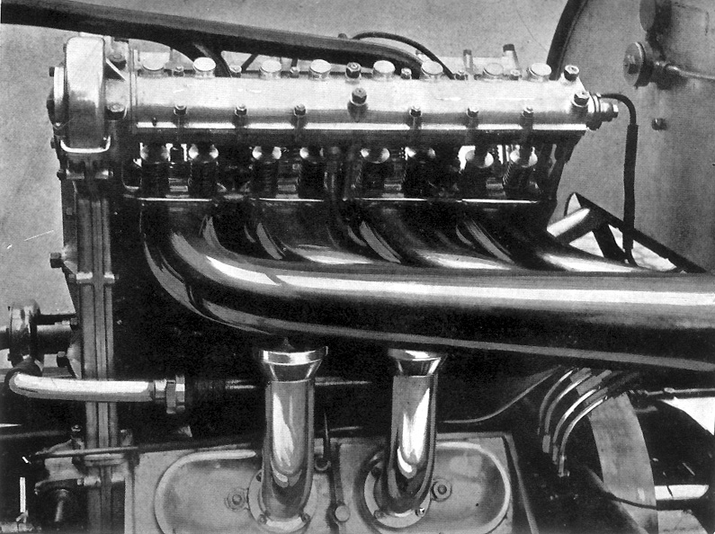

It ll started in the mind of this brilliant engineer named Ernest Henry. While working for Peugeot he designed an engine that was the first to combine four valves per cylinder and a double overhead cam four cylinder engine. That engine powered the famous Peugeot L76, which dominated the Grand Prix scene of that era. In 1913 Jules Goux driving a L76 won the Indianapolis 500, the first European car to do so. Peugeot continued to campaign in the US, also winning in 1916 and 1919.
Some of those cars remained in the US, and came into the possession of Henry Miller, a giant of his generation. He took many concepts from this engine and designed his own four valve per cylinder, double overhead cam four, itself a winning engine. But Miller went bankrupt in 1933, and sold his business to Offenhauser. He developed that engine further, into what was known as the Offy. There is a wonderful pedigree behind that engine, refinement, reliability, and success. One reason for that reliability was that the head and cylinders were integral, eliminating the need and weakness of cylinder head gaskets.
