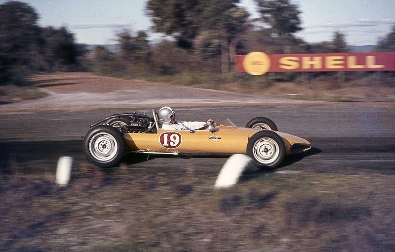

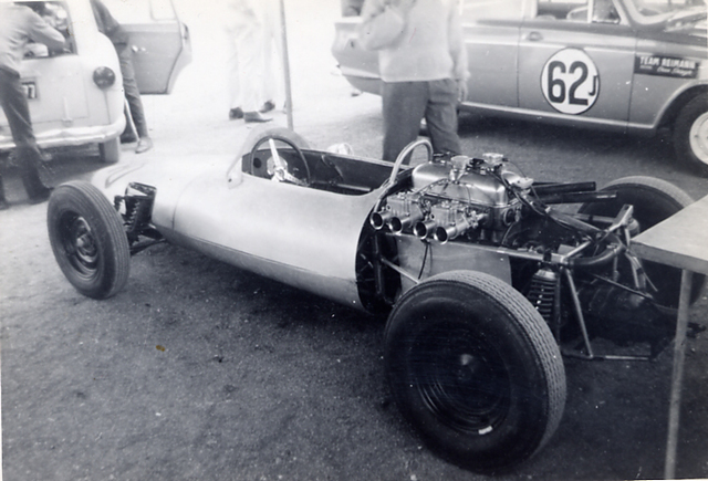

Back in the early 1960s "Brave" Dave Sullivan, multiple local touring car championship winner, turned to single seater racing and in the manner of the times designed and built his own rear-engined car using the tried and tested combination of space frame, Peugeot engine and VW transaxle. And we have the pics:

#3 Terry Walker
Terry Walker
  • 3,005 posts
Posted 05 July 2015 - 11:31
The last few now I've got the hang of it.

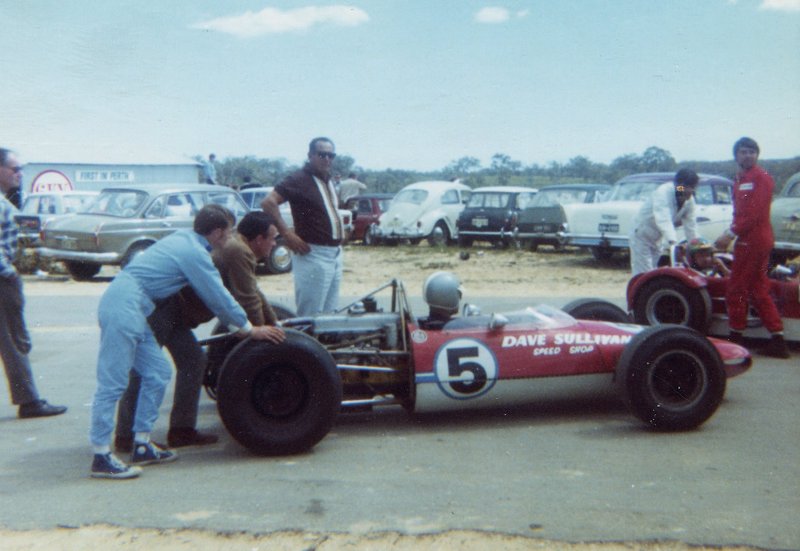

Dave went on to win the State's Racing Car Championship, in due course the car gained a fully independent rear end and a Holden 6 cyl "grey" motor instead of the Peugeot. was eventually retired from racing, made a comeback at the newly opened Ravenswood drag strip (fastest in the first season), and finally acquired a small Ford V8 was but never raced in that configuration.
When son Dave Sullivan Jr was of racing age, he made his debut at Caversham in his Dad's DSM,, and a few years later was racing his own U2 Clubman at Wanneroo.
Dave Sr is now 98 and in a nursing home, and Dave Jr has commissioned me to scan his Dad's ond photo albums.

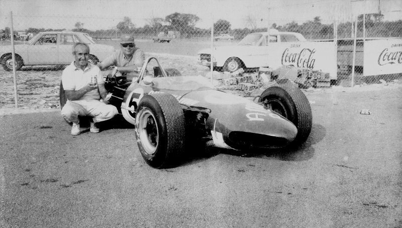

Oh, and the car is still in the family, although the mild steel tube chassis is completely rusted out. The rest, including the hand-formed aluminium body, is in storage.
#5 Ray Bell
  • 82,361 posts
Posted 05 July 2015 - 12:00
Widened Simca wheels at the front?
I don't recognise the front uprights...

As I recall, Dave asked famous WA artist, the late Robert Juniper, to draw up the body, obviously inspired by the 'Sharknose' Ferrari.
                 Cliff Byfield then made the body.

As ever, always very interested in this type of thing, so, from what make did they source the stub axles/kingpins/front uprights? Was the Peugeot from the 403?
Looking forward to more photographs.
Many thanks
edit. Sorry Ray, I did not read your post fully re uprights. In enlargement  it looks as if they might have been cut and extended, which may account for the shepherd's crook element at the top.

Roger, the odd bit with the uprights is the king pin setup...
Most of that kind of upright had ball joints for turning. Could they be some kind of BMC with the top bent over?

Ray, looking by chance on the Revs/Mainlander archive , there is a shot of an f2 Simca front end. Uprights look very similar. Obviously they would have been cut and extended to give new top and bottom pivots. Does anyone have any other ideas?

Posted 05 July 2015 - 22:35
They are weird. Greased pin lower are and a balljoint upper,, on a KING PIN suspension? It has to be fabricated, and wrong. It seems to have plenty of bump steer built in too! Early 60s would have had a variety of balljoint uprights available. The oft used Herald ones for instance.
The rest of the car looks quite good for that period of car.
The bodywork is very pretty.
The clevis's in the rear will bind it up too. And load up the pick up points severely. This is with 50 years of hindsight and the ready supply of heim joints.
Edited by Lee Nicolle, 05 July 2015 - 22:41.

the Peugeot would be 203, with the long sump.

Lee, the Simca has a yoke like that at the bottom, with a similar one at the top, changed on the DSM with a welded add on.
A king pin front suspension generally has a greased metal thread top and bottom. In effect a through bolt. This allows full up and down travel but no rotation at all. The steering is all pivoted on the king pins. A  perfectly functional system though overshadowed and replaced by the mid 60s at the latest by the ball joint where the ball joint allows up and down movement as well as steering rotation. Generally better steering geometry can be achieved also.
The king pin deal is really a throwback to beam axles where it is still used on most trucks. A beam axle has little choice!
As far as I remember  early Simcas were the norm as I described, in fact I feel later Simca Arondes [early 60s] were ball joint anyway.
With a king pin the only caster available is built in to the car, or possibly lay the crossmember back [ a racecar mod] Some have some camber adjustment by shimming the top wishbones in or concentrics in the lower. Otherwise camber is achieved by bending the upright. [again a racecar mod]
Neither is great on a road car however.

The Simca Aronde, dating back to the mid-fifties, had a ball joint at the top at least...
This ball joint was slipped over a straight shaft on the upright and held in place by a roll pin. I don't remember what the bottom was, but I'm pretty sure there was no king pin.
Another car with the same wheel stud pattern from those times was the Skoda Octavia.

Rare colour photos, one of its last appearances, Wanneroo Park probably 1969:
screen shots
how to take a screen shot
That's Dave Jr in the beard, and in the background of the top shot you can see young Dave in his newly finished U2 Mk 8B.
Edited by Terry Walker, 06 July 2015 - 03:00.

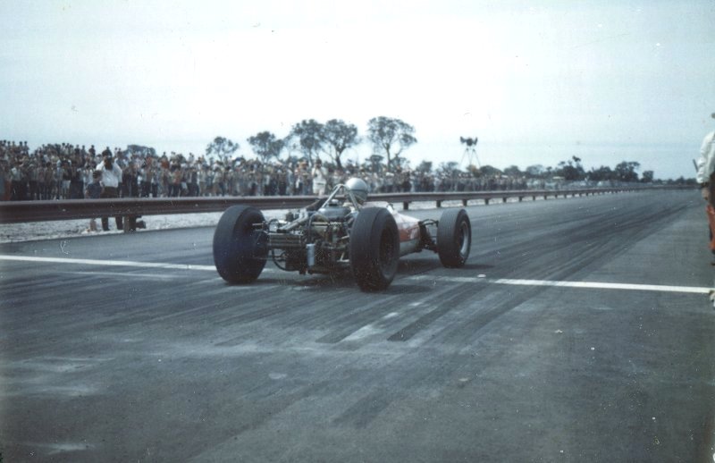

And here it is at the end of its active career, as a dragster. Yes, and I think the lettering on the nose is A Mod, dragster class. There were no dragsters in WA when Ravenswood opened. so for a short period of time there was room for something with little weight, enough power, and a sharp driver. The colour shot shows the car on the line; the b/w shot Dave with a Swan Lager can and I think Con Migro.
adult photo hosting
screen shot
I don't know if that's a unique distinction, but single seat racer and dragster... and top at both!
adult photo hosting
screen shot
Drag racing with a Holden motor,, and a VW gearbox. Poor gearbox!
Should be quite [period] quick if the gearbox does not explode
