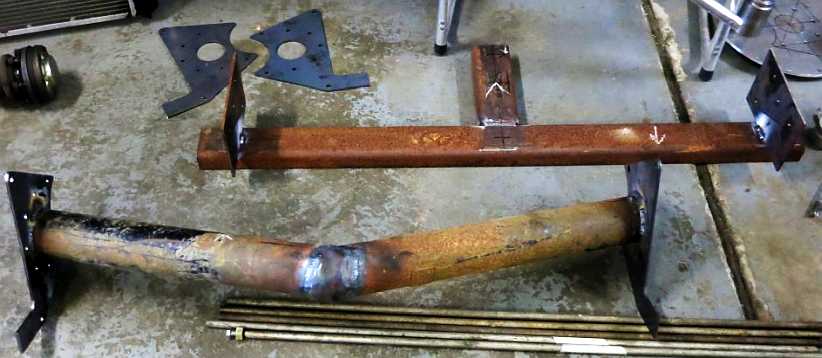

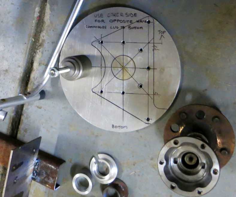

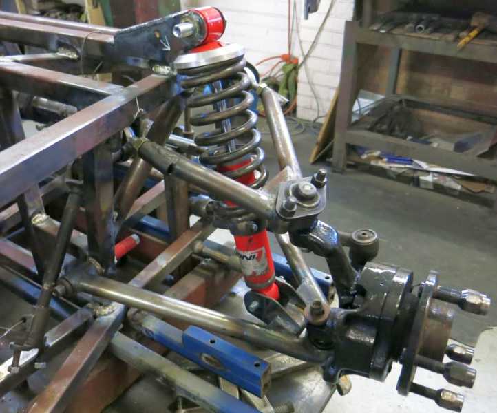

Fortunately Pat Clarke was among those who joined Bob for his Saturday afternoon this week...
So we have some update photos on the Maserati 300S lookalike, principally of the suspension progress. The de Dion tube has just been welded together, but first Bob had end plates cut by laser (not much gets jobbed out at Rennmax, but these took so much work to make last time it paid off). To do that, of course, drawings were required, so here are the steps:
0219-Drawing-Cardboardtemplate-Finisheda
Rough drawing, proper drawing from the drawing board, a cardboard cutout and the plate cut to shape and with the holes also laser-cut.
0219-Jigforlasercutting-De-Dionadaptorpl
The jig produced to get the holes accurately cut.
And so it's progressively transformed into a component for the car, a vital component in the rear end.

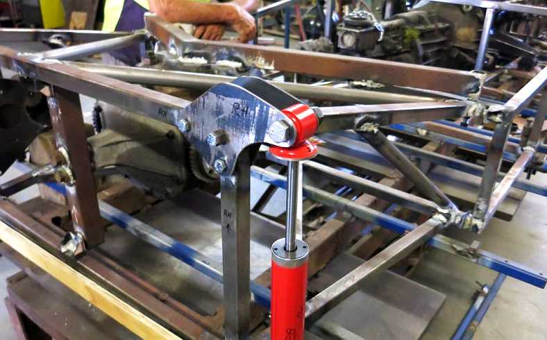

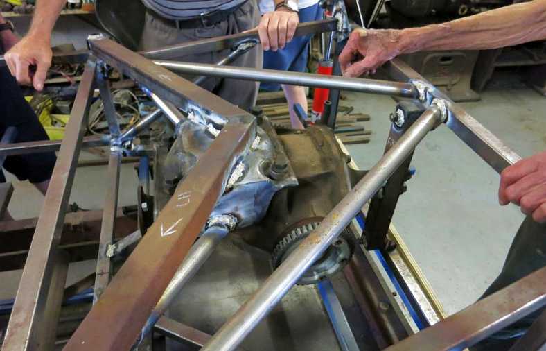

And this is where it will go, the Holden final drive is bracketed in place and Saturday afternoon visitors check the handiwork. Of course the mounting is very solid to cope with torque reaction forces:

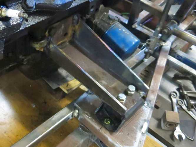

Meanwhile, there has been progresss up front. Engine mounting brackets:

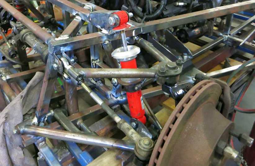

And the front suspension, which with this car doesn't have the rockers to put springs and dampers inboard...
Note here that Bob has adapted the Commodore wheel bearing setup to Gemini ('70s Kadett to Europeans) uprights.

You see a couple of areas there where Bob has gone for a 'rough and ready' solution rather than his usual finesse...
One is the engine mount brackets, like pieces from a railway workshop, while there's not much character in the differential mountings.
"I just want to get this done," he told me, "so there isn't time to make up tubular brackets like I normally do."
The fact that most of it will be hidden under one of Les' beautiful fibreglass bodies counts for a bit too.

The rear suspension bay of the newest creation, still to have the halfshafts shortened but with the tail shaft fitted.
Looking over the de Dion setup from the rear.
The rear suspension and brake, straight from the Commodore.

Another step in the progress of the Maserati 300S lookalike...
The flywheel and clutch have now departed Timbumburi and will be in Sydney some time this week.
In the meantime, Bob has completed the welding of the chassis, it's out of the jig, I'm not sure what the next stage is - sandblast and paint or do more fitting-up of parts (including working out the clutch pedal ratios).
He remains excited about this car...
#431 Ray Bell
  • 65,132 posts
Posted 06 April 2019 - 12:41
Today the flywheel and clutch met the motor for the first time...
With thanks to Marc Schagen for transporting it there.
It wasn't a happy event, however, as there was some fouling between the flywheel and the starter motor housing. Nothing Bob couldn't solve, however.
With plenty of intelligent and experienced people around it wasn't long before plans were being laid to fix this. Helping with Bob here is Ray Eldershaw.
Measuring twice before cutting... the golden rule.
Bob soon had it in the lathe, job done.
Over the last couple of weeks he's been working on the pedals and steering column mount.
The acquisition of a Sprite fuel tank saw it go into place.
With the gearbox in place... and the front of the chassis is basically complete, the steering rack being a shortened Holden Gemini unit.
I'll need to ask Bob what that cutaway in the bellhousing is all about...
Bob's method of rejoining the half-shafts after shortening.

Ray,
The cutaway in the bell housing is to make room for the starter motor which is on the opposite side on the donor engine.
Pat
