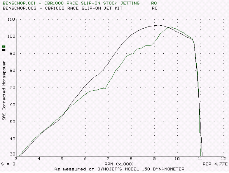

#17 MatsNorway
MatsNorway
  • 2,831 posts
Posted 01 December 2017 - 21:40
Mats, width of powerband should always be measured in %. eg an engine that makes 100hp from 2000 to 4000 rpm is comparable to one that makes 100hp from 5000 to 10,000 rpm.
Due to gearing i presume. I was just going off Ducati claims a few years back..perhaps it was pr. talk. lets try and see if that is a pattern that holds true.  I am sure i can dig something up from internet.
CBR1000 (1987-1991)
Dyno-Honda1987-91-CBR1000.gif?d=1&i=1
Source: https://www.totalmot...da-CBR1000F?d=1
wpid-2015-honda-sport-bike-motorcycle-hp
http://www.hondaprok...br500r-cbr300r/
quick and dirty estimate of same effective range:
87mod 55hp/5k to about 105hp/9k (dif:5,5k)
vs 2015 105hp/6,5k to 185hp/13,2k (dif:6,7k)
Looking at this i suspect i either remember wrong or Ducati being full of ****. Because ducati had on all dyno runs engines that did 10-11krpm regardless of year and engine size for the R bikes all the way from the 90s to today.
That was interesting.. either piston speed is the limit or.. (my suspicion) the desmodromic valves have some sort of limitation)
ex: http://www.ducati.ms...spa-13-dyno.jpg
It took me really long time to find decent graphs. Hope for interesting analysis of the graphs, GG and others. Have to go now.
Edited by MatsNorway, 01 December 2017 - 21:47.
