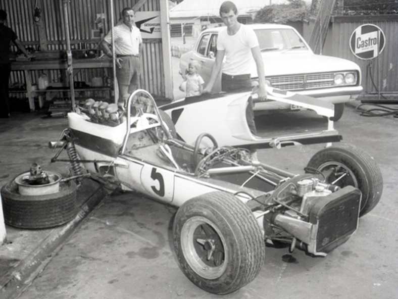

I'd expect someone around here has pics of the 39 with the nose off to help see the front of the chassis...
Wirra? Dick Simpson?

I believe that the v-shaped oil tank and slimmer radiator first appeared in 1963 and so were nothing to do with difference between the 25 and the 33. There is a photograph in Ian Bamsey’s book Lotus 25 - A Technical Appraisal showing the oil tank.
Bamsey also says that the installation of the fuel injected Climax engine required a 1 inch increase in wheelbase. Fuel injection first appeared on R4 in South Africa, December 1962. R5 was brand new in South Africa but had a carburettor engine at that stage. I don’t know whether the 1962 cars were modified with longer wheelbase. The first new car for 1963 was R6 which appeared in Austria in September.
I don’t understand mariner’s point (4) about the front rad area being changed to allow cold air to get to the Lucas “bomb”, the high pressure pump for the fuel injection. I thought that Lotus fitted the bomb at the back of the car, next to the gearbox. They may have moved it later but I couldn’t find any record of that.

#36 Ray Bell
  • 82,361 posts
Posted 23 June 2019 - 21:06
We've come all this way and that's the first pic in the thread...
Well, here are two more:
Taken after Leo's Bathurst crash by Lance Ruting, now on Autopics.
#37 Ray Bell
  • 82,361 posts
Posted 23 June 2019 - 21:15
Originally posted by Roger Clark
.....The 32B had suspension and transmission beefed up to cope with the increased power. An HD Hewland gearbox was fitted. The monocoque around the engine bay was removed and replaced by a tubular structure.
Sorry, Roger...
No tubular structure. The monocoque went to the rear suspension.
And I know there were LOTS of rivets in that chassis.
I guess the fitment of the engine differed from normal FPF installations because of the restrictions of the monocoque, the engine was either upright or more upright that usual.
Is that Geoghegan's 39 Repco

#49 jeremy durward
jeremy durward
  • 288 posts
Posted 25 June 2019 - 04:58
So looking at this while the 33 had moved to straight internal sides this car was built with the kinked internal sides. Is this a move back to the old style of chassis? or was this built before the straight internal side chassis? despite what chassis numbers would lead us to believe.
