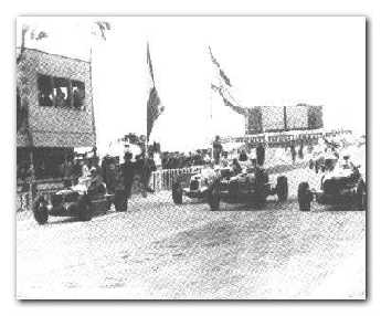

I've found a picture of the start of this race. A light-coloured car is clearly visible here too. If the grid in Sheldon is correct, then it appears to be Brezzi in a Scuderia Torino car.
But, according to the site it came from, there were fifteen starters, with Brezzi a non-starter!. Sheldon says sixteen, while the limited reports I've seen say Brezzi crashed. Might he have crashed before the start? In which case, who's in the light-coloured car?

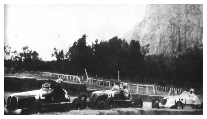

Well, thanks to some help from Alessandro Silva, I can now say that the picture in Venables is not 1940, but 1938. The mysterious light coloured car #12 is de Teffé's yellow Maserati. It might also be the one on the right here:
So - is the start picture above actually 1940? If so, whose is the light coloured car? If not - is it also 1938? Or has Sheldon got the 1939 grid the wrong way round, in which case the light coloured car is Pietsch's white one!
And I'll ask again - has anyone got the race numbers for 1940?

About the start picture: 1940 seems unlikely to me, too, as in this case I would have expected to see 4CL models in the first row. So looks very much like 1938 to me, too, and in this case the bright car might indeed have been Pietsch, de Teffe or even "Georges Raph".
But if we are not sure about the date of the picture, how sure is the place?

The pictures posted by Richard are definitely not from 1940.
Just to be sure, as this is completely new to me: For 1939 Sheldon says Pietsch drove a 6CM entered by the Maserati factory (Hence I would expect nothing else but a red car). Are you sure you don´t mismatch this with 1938 when he indeed drove his own 4CM-engined 6CM (4CM 1937), which was of course silver?
