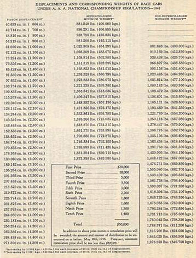

#15 Don Capps
Don Capps
  • 5,933 posts
  • Joined: May 99
Posted 15 February 2004 - 23:13
Originally posted by D-Type
Did the AAA adopt the formula in its entirety, i.e. including the sliding scale of minimum weight vs engine capacity, or did they simply adopt tjhe maximum capacity limits?
Judge for yourself....

#17 D-Type
  • 9,759 posts
Posted 16 February 2004 - 09:10
An interesting insight into different attitudes on each side of the Atlantic is the inclusion of minimum prize money in the regulations. In Europe they hardly acknowledged that there was any money involved . . . . then Bernie came along.
