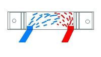

In the “Spray Penetration and Mixing” reference / analysis (www.osti.gov/bridge/servlets/purl/2...able/206549.pdf), there are 20 plots in total, having, all of them, the TIME (MS) as the basic parameter. The same is true for the running engines (the time is the main parameter, not the crank angle).
The penetration and mixing is a pure physical process.
The spray leaving the injector nose doesn’t know whether the engine operates at 1000 rpm or at 5000 rpm. The only that the spray feels is the hot, moving, compressed air.
The struggle in the Diesel engine is to realize the penetration and mixing of the fuel in the most efficient way. And the limiting factor (the enemy) is the time.
In the advantages of the OPRE, PatOP and PatFour, add one more significant: the additional time the piston dwells near the CDC (combustion dead center).
Fuel's Viewpoint :
The following animation shows the piston motion near the TDC of the OPRE engine revving at 6000 rpm versus the Conventional revving at 4500 rpm, for equal piston stroke and equal (1.65) con-rod to stroke ratio.
Without seeing the kinematic mechanism, how can you reply to: " WHICH is the Conventional and WHICH is the OPRE ? "
Suppose you are a fuel droplet injected either into the cylinder of the conventional or into the cylinder of the OPRE.
What you 'see' is the 'walls' of the combustion chamber, i.e. the cylinder head (if any), the piston top and the cylinder wall.
What you 'touch' is air of some temperature, pressure, turbulence and swirl.
As you have no way to 'see' (or 'feel') the crankshaft or the kinematic mechanism, you cannot say (for sure) that you were injected and burned into the OPRE revving at 6000 rpm or into the Conventional revving at 4500 rpm.
Combined with the half piston speed of the opposed piston arrangement and the highly efficient uniflow scavenging, the additional time for the injection / combustion of the fuel, enables far higher power density. At the lower revs this extra time improves the fuel efficiency and the clean exhaust
By the way, with the bowl on the piston crowns of the PatOP (my previous post), what are the desadvantages as compared to the conventional state-of-the-art direct injection Diesels?

Just my impressions:
One disadvantage might be uneven temperature across the piston crown - higher temperatures on the "bowl" side. (Considering thermal expansion of the piston - not combustion chamber thermal smoothness which must be excellent)
On the "plus" side"
The fuel is injected along an axis of symmetry and this remains an axis of symmetry as the pistons move apart.
The squish geometry lends itself to creation of ideal air motion, with high velocity in the opposite direction to the fuel spray. Congratulations on your combustion chamber design. Did the shape evolve much with CFD or is this similar to your starting design?
I must say, the more I look at this engine the more I like it.

Hey Manolis, I think the arrows representing injector flow in your combustion chamber illustration are pointed in the opposite direction of where they should point. You have the injector flow coming from the squish area and not the hole in the piston combustion chamber...

#119 manolis
manolis
  • 940 posts
Posted 01 May 2011 - 17:15
Gruntguru wrote: “Congratulations on your combustion chamber design. Did the shape evolve much with CFD or is this similar to your starting design?”
The bowl design is simpler than it seems.
Take an angular part, about 150 degrees, of the typical bowl of the current four stroke direct injection Diesel (like a piece of a pie), and put its “symmetry” axis as close to the injector as possible, leaving a safety distance from the piston ring-lands.
Do the same on the opposite piston, and you have a quite compact bowl (big volume to surface ratio), near to the injector nose.
With one injector per cylinder:
in the case of flat crowns (i.e. without bowls), the spray has to travel some 80mm (i.e. the cylinder bore) to find all the air,
in the case of piston crowns having bowls (PatOP prototype), the spray needs to travel less than 30mm (one third). And the air, during the injection, comes from the opposite direction (upstream) relative to the fuel spray, significantly improving its vaporization and mixing.
For true high-speed direct injection Diesels (peak power at 6000+ rpm) this is vital.
Think: at 6000 rpm, in 1 millisecond (i.e. in the time necessary for the spray to penetrate for some 50mm into the compressed air) the crankshaft rotates for 36 degrees.

Unclematt wrote: “Hey Manolis, I think the arrows representing injector flow in your combustion chamber illustration are pointed in the opposite direction of where they should point. You have the injector flow coming from the squish area and not the hole in the piston combustion chamber...”
No.
The arrows depict the air stream coming from the flat areas as they squish the in-between the pistons air to force it into the bowl. The fuel injector is at the opposite side to inject upstream (oppositely to the air stream).

Hey manolis, sorry about that, I thought it represented injector flow.
What is the roughed up area on the left piston to the left of the combustion chamber? And how about the thermal differences caused across the piston crown by the asymmetrical combustion chamber? Any concerns there?

Unclematt wrote: “What is the roughed up area on the left piston to the left of the combustion chamber? And how about the thermal differences caused across the piston crown by the asymmetrical combustion chamber? Any concerns there?”
The reflection of the flash of the camera makes the surface seem rough at the intake piston at left.
What the thermal differences across the piston can cause to a piston like this?
If you mean the deformation, the crosshead design is insensitive to this.
As for the ring lands, they can deform axially without a problem.
Besides, the cooling of the back side of the piston crown is way easier than in the conventional pistons with the piston pin, the piston pin bosses and the small end of the connecting rod hiding the back side of the piston crown from the crankcase oil.
Many conventional pistons – which are way more sensitive to deformation – have the bowl offset from the cylinder axis (direct injection Ford engines, for instance).

Posted 03 May 2011 - 12:16
About the asymmetrical timing in the two stroke engines
A conventional two stroke that controls the intake and exhaust ports by the same piston, has symmetrical port timing.
If the intake ports open at x degrees after the CDC (Combustion Dead Center), they close at x degrees before the CDC. Similarly, if the exhaust ports open at y degrees after the CDC, they close at y degrees before the CDC.
In the opposed piston engines, things are different because different pistons control the intake ports and the exhaust ports.
Take for instance the OPRE prototype engine:
which, in this photo, has symmetrical port timing (the volumetric scavenging pumps fit to this timing).
If you ****** the intake crankshaft, at left, for 2 gear-teeth, which is about 13 crankshaft degrees (all you have to do is, during the assembly of the synchronizing gearing, to “time” differently the gears), you put a significant asymmetry in the port timing (the vibrations increase, but not too much).
The CDC (combustion dead center), i.e. the point wherein the combustion chamber volume is minimized, is at +6.5 degrees of the exhaust crankshaft and at –6.5 degrees of the intake crankshaft (zero degrees for a crankshaft is the angle at which the piston is at the maximum distance from the crankshaft axis).
The exhaust ports open at, say, 100 degrees after the CDC and close at 113 degrees before the CDC, while the intake ports open at, say, 115 degrees after the CDC and close at 102 degrees before the CDC.
In the Junkers Jumo direct injection airplane Diesel engines, the intake crankshaft is ******** for 11 crank degrees. Besides the asymmetrical timing, with such a phase difference most of the power is delivered to the exhaust crankshaft. Those engines are still famous for their excellent scavenging efficiency (pure uniflow scavenging, long stroke, small bore).
In the Deltic opposed piston engine, the geometry made necessary a 20 degrees phase difference between the intake and the exhaust crankshafts. Not the optimum, but it works.
In the OPRE engine, a 7 crankshaft degrees phase difference has the same effect as the 11 degrees in the Junkers Jumo engines, because of the different motion of the pistons. A 7 degrees difference has very small effect on the vibrations, however with a volumetric scavenging pump no phase difference is necessary.
To make the same in the PatOP, the intake crankpins must be angularly displace for 7 crank degrees (alternatively, the crankshaft can be offset relative to the cylinder axis, etc).
You can also take a look at the Commer TS animation, in one of my previous posts. It uses asymmetrical timing, too: the exhaust ports open earlier than the intake ports, the exhaust ports close earlier than the intake ports.
I think the meaning of the asymmetrical timing in the two stroke engines is now clear.
The volumetric pumps and their reed valves are responsible for the “four stroke” breathing of the PatOP and OPRE engines.
In the photo below:
fresh air passes through the “holes net” (at the four corners of the bottom cover) and then from the air filters before it finds the intake reed valves.
The turbochargers have their own limitations that are added to those of the basic engine. A bad characteristic of the supercharged direct injection Diesels is their short rev range: plenty of torque, but in a short rev range. The driver has to deal with the gearshift lever all the time.
Think of a conventional diesel that can make its power band broader by 35%, and how many gearshifts saves for the driver and how much economy it can bring about.
On the other hand, using the same turbocharger in the PatOP engine and in a four stroke of same capacity, the relation of the air passing through the two engines remains the same: 1700 versus 635.
As for the power, the PatOP burns once per crank rotation, has more compact combustion chamber and plenty of time to burn the Diesel fuel at higher revs. For road traffic the wide power band is more important than the peak power.
The four-stroke is a heavy prime-mover chiefly because of the cylinder block, the cylinder head and the studs that must keep them together.
The OPRE, PatOP and OPOC has none of them; their weight is way less than half.
Of course, as two-stroke engines they cannot be quiet, neither clean, nor fuel efficient, and, worse even, nor generally likeable!
Manolis Pattakos

cheapracer, on May 4 2011, 01:29, said:
These engines makes the OPOC boss a person who speaks untruths as he says quite clearly here "you can only do this in an OP engine" ...
Tke picture you have posted is clearly a variation of the opposed piton design, having two pistons sharing a common combustion chamber.

#149 cheapracer
cheapracer
  • 10,388 posts
Posted 04 May 2011 - 05:16
gruntguru, on May 4 2011, 10:23, said:
The picture you have posted is clearly a variation of the opposed piton design, having two pistons sharing a common combustion chamber.
I would think they both came about for entirely different reasons/applications. I'm not here to support the split single merely mentioned that it has staggered timing.
As for scavenging, that is a secondary effect because you have supercharged - positively displaced - pressurised - increased the volume within a given area etc etc, call it what you want but scavenging does not happen by itself in a 2 stroke (well not enough for our purposes anyway such as starting the engine ;) )
