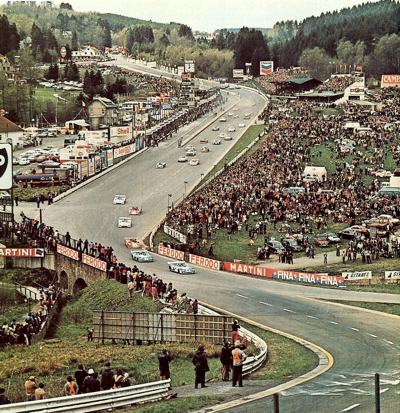

I'm not sure if there is an uprising trend. It's always been a very dangerous bit of racetrack. Just think back to Bellof, Zanardi, etc.
I think the best thing to do would be to slow it down by taking it back to the pre-1983 shape. In 1983 the current shape was adopted, and for many years the left-hand side of the track was still in the old shape leading to a very wide but unused bit of track. Since the new runoff was first put in in 1995 it's been the same width. See below. Despite having barriers much closer to the track, the racing line is the same as today. But modern cars of all sorts have so much more grip than in the old days, it makes the corner much faster.
Now look at older photos. The "chicane" is much more pronounced. The racing line is much further to the left overall, with a tighter first part leading to more of a straight to a tighter second part. It would still be a challenging corner, but it would force most types of car to have to slow down a lot more than they do today.
7538258e9c5eb8dc923be4426514c9bd--nice-p
Photo-Eau-Rouge-500cc-GP-Spa-Francorcham
It's actually quite difficult to find photos of it in the days of the modern circuit, but before the change was made for F1 to return. But any picture from the old circuit really drives home the difference.
So I think that's the best way to go about it. Make it slower, but keep the general shape and character. Something a lot more sympathetic than the 1994 chicane.

It's really hard to have a real idea of how different it was. Every picture has a different perspective
